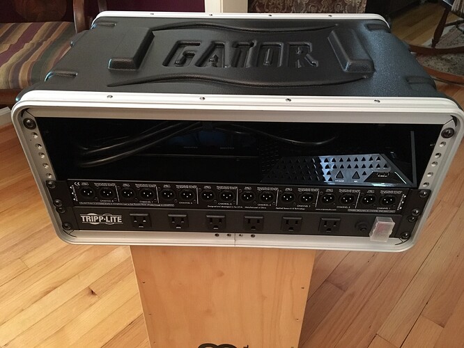

I’ve just used the Gator GR-4S shallow rack. You’ll see the low profile XLR connectors from Cable Techniques (https://www.cabletechniques.com/lopro-xlr-mini-xlr) on the front. These are great because the case cover still fits with these in place. This means I can mount additional equipment in the rear of the rack and leave it wired in. I also have a NetGear router. I selected that because it has a WiFi-off button, so in venues where we aren’t allowed to use WiFi I can make a wired connection to the mixer from the iPad.
![[URL=https://s1082.photobucket.com/user/andyoz1/media/IMAG2732-Edit-1_1.jpg.html][/URL]](https://us1.discourse-cdn.com/flex002/uploads/allenheathdigitalcommunity/optimized/2X/4/469786a6b7b46d620df455758b4ce7fdfdf0aace_2_690x390.jpeg)
