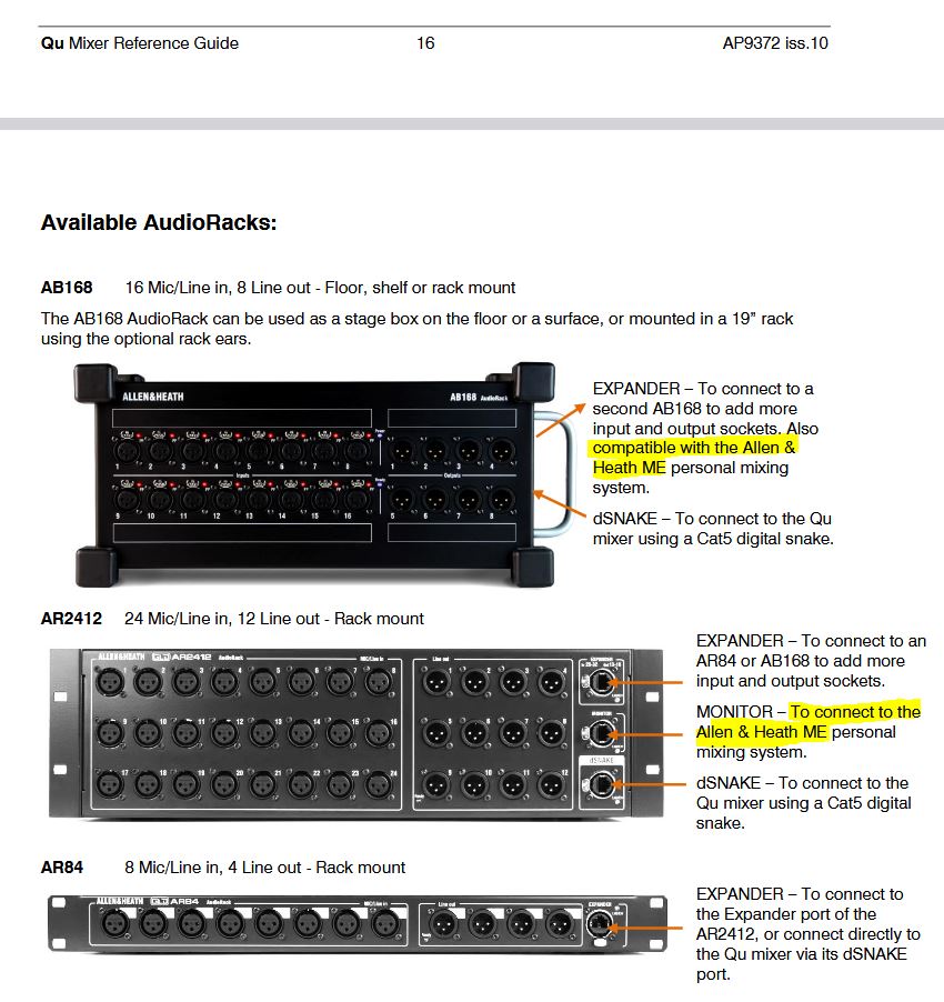

Is it possible to connect an AR84 to the link out of an ME-500 that is connected to the dsnake of a QU16 mixer?
Because I’m not sure how to connect both ME-500 and AR84 to my QU16 to make it work.
Unfortunately, this isn’t possible with an AR84.
You’d need one of the larger stage boxes for that.
