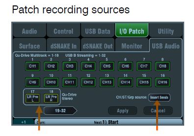

Did you do the right USB-B Routing?
To change channel source go to the input Processing screen
Fn key Source page.
Set the Global USB Source button to … “USB B”!!!
Select the chabbels, you want to have recorded.

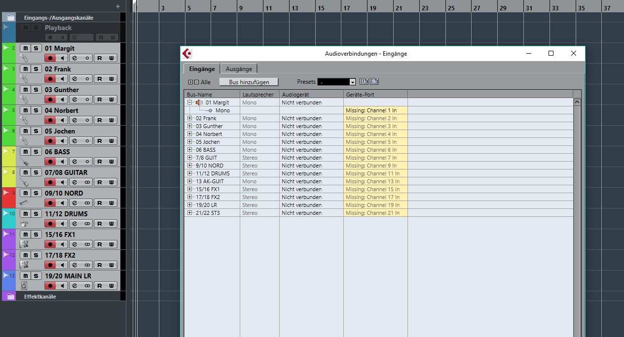

In Cubase you have to go to
“Studio” - “Audioconnections” - Inputs and Outputs an have to create the correct connection for every channel…
