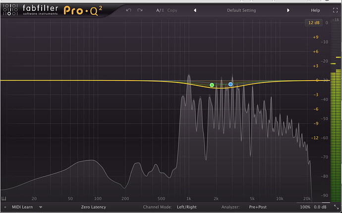

FWIW we’ve been waiting for some years for A&H to implement something like the `fabfilter pro Q style plug on the Ilives and now on Dlives…overlay directly on the parametric EQ…
Ray
Oh that would be awesome!
It’s a shame that even the $299 Behringer X-AIR includes such a feature, and our beloved dLives don’t.
