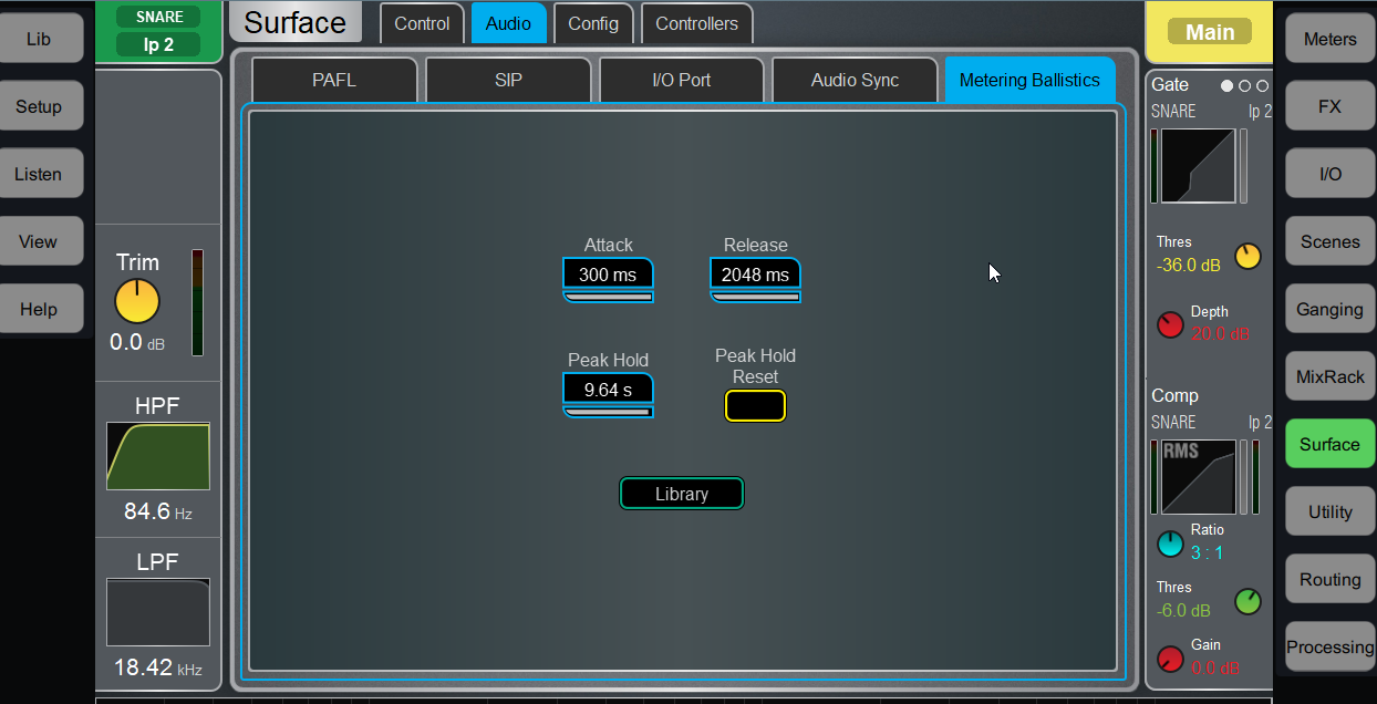

BTW, one can configure the metering ballistics.
But the difference between Peak and RMS metering is not only in timing settings, no?
I have had to adjust the metering ballistics as I noticed right off the bat that it was a bit too slow, and the peak metering was a bit too fast by default.
