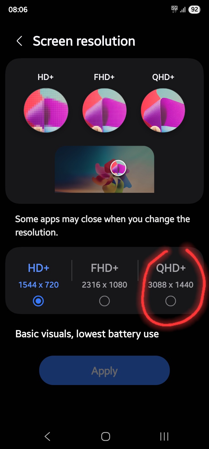

I tried changing the screen resolution to the highest setting and it fixed everything. The only issue is that it has more battery consumption.
