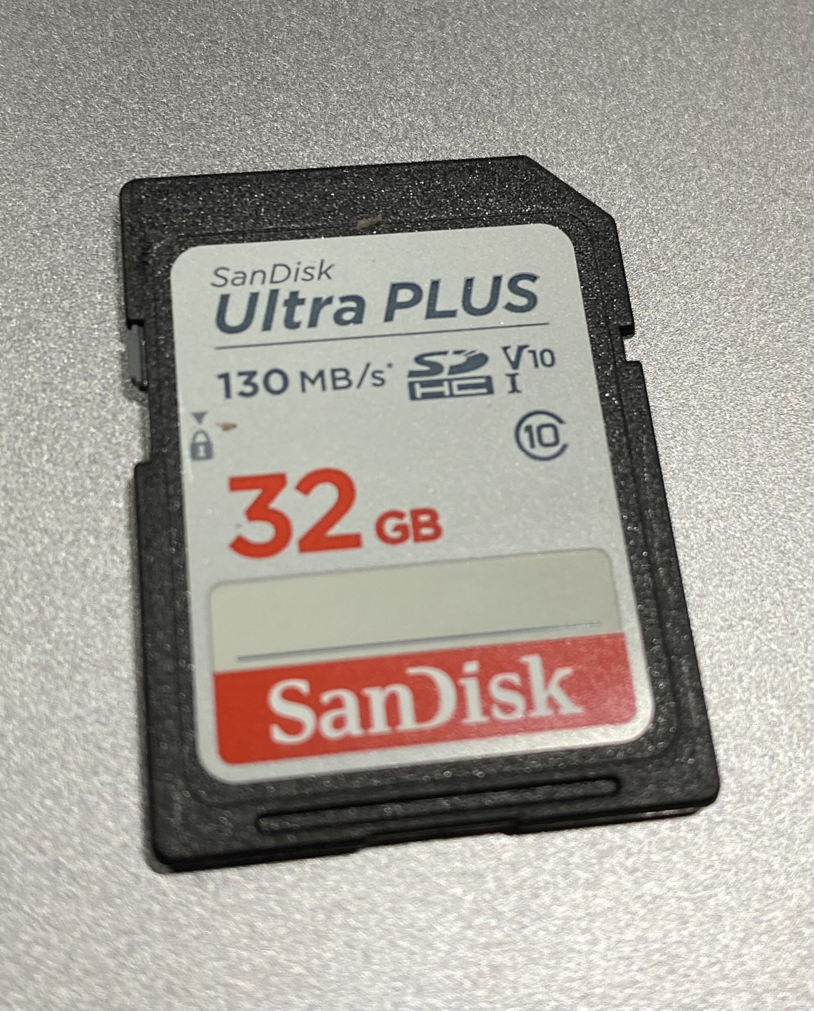

Been doing some testing with SDXC v SDHC cards on the mixer. So thought Id post my observations.
The two cards Ive been testing with are.
SanDisk Ultra (120mbs read) Class 10 U1 SDHC 32Gb
Kingston Canvas Select Plus Class 10 U1 SDXC 64Gb
The recommendations from A&H are SDHC cards only
My findings
Its possible to use SDXC but you must:
1: Format the card on the computer the mixer won’t do it
2: Ensure you Format to FAT32 file system (MBR best) On a Mac the Disk Util will do it on Windows you need extra formatting software as the OS won’t do it. The mixer only works with FAT32 File System.
3: Manually recreate the Folder Structure the mixer requires to write the multi stream recording files to. The Mixer Format utility appears to format and write the folder structure as part of the format process.
What I didn’t test is whether a format of an SDHC card on the computer without putting the Folder structure on it manually would allow the mixer to record correctly. With the SDXC card it wrote files but their file headers were corrupted so no playback possible.
SDXC can then give you three arguable benefits
1: Slightly higher write speeds. (SanDisk SDHC 36mbs write 120 Read Kingston SDXC 40mbs write 90 Read)
2: Higher storage capacity (whether thats a benefit depends on your workflow in normal day to day use)
3: The card is later tech and can probably be used in more devices going forward.
Having been able to identify the specific cause of the audio dropout issue yet so yet to see whether the marginal increase in card write speed makes a difference, that will have to wait till next rehearsal. But using 48K in place of 96K sample rate ought to give lower processor overhead. However given the Sandisk Card is the one A&H show in their information re SD Card compatibility and appears well within the bandwidth specs for audio recording you would have believed that it shouldn’t be the cause of the multi stream recording dropouts.
