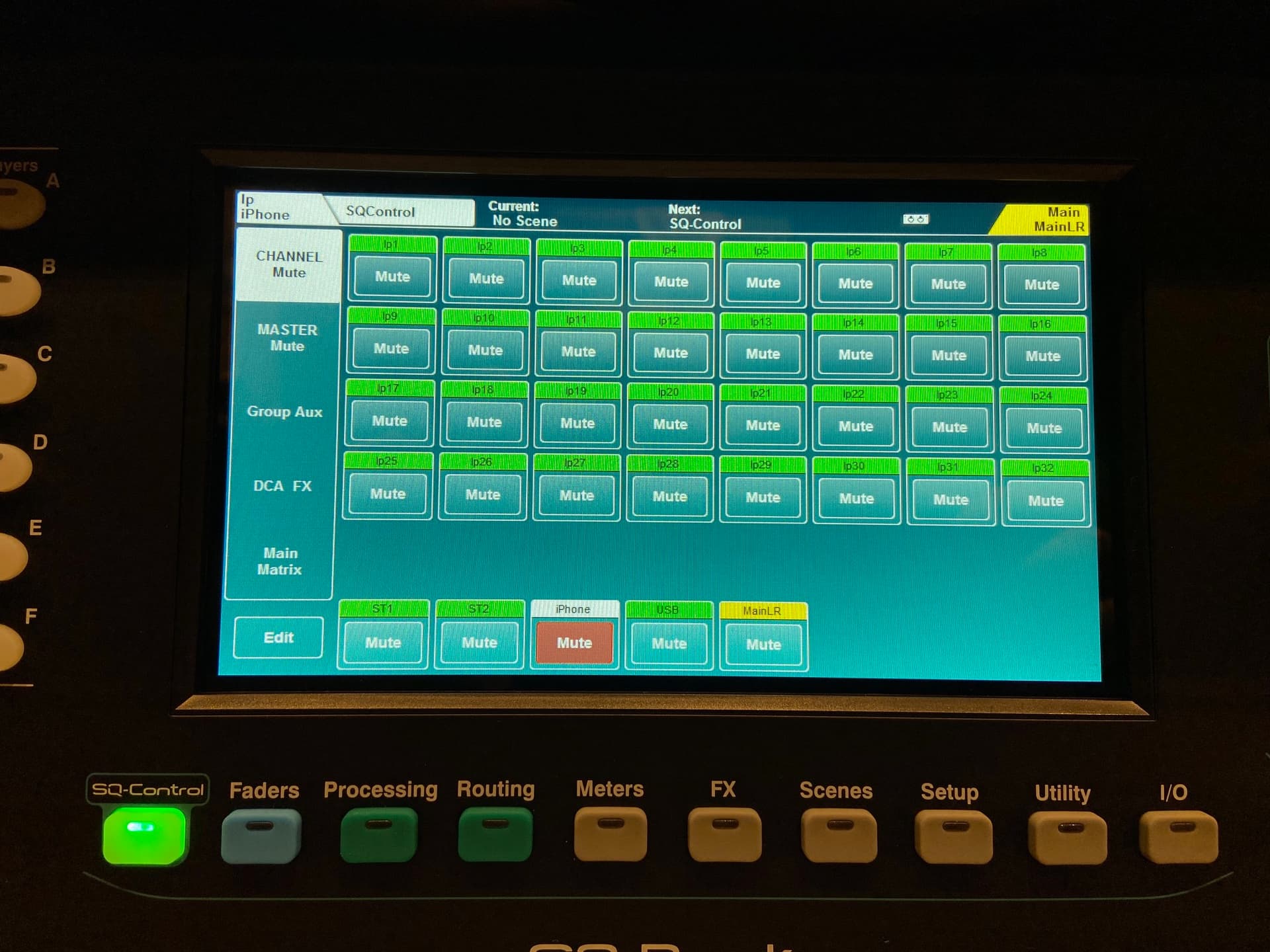

SQ-Control is really the right tip here. Thank you very much. I can build 5 layers and control everything directly on the SQ Rack. Picture 1 my mute overview. That’s exactly what we need. Thanks for your help
