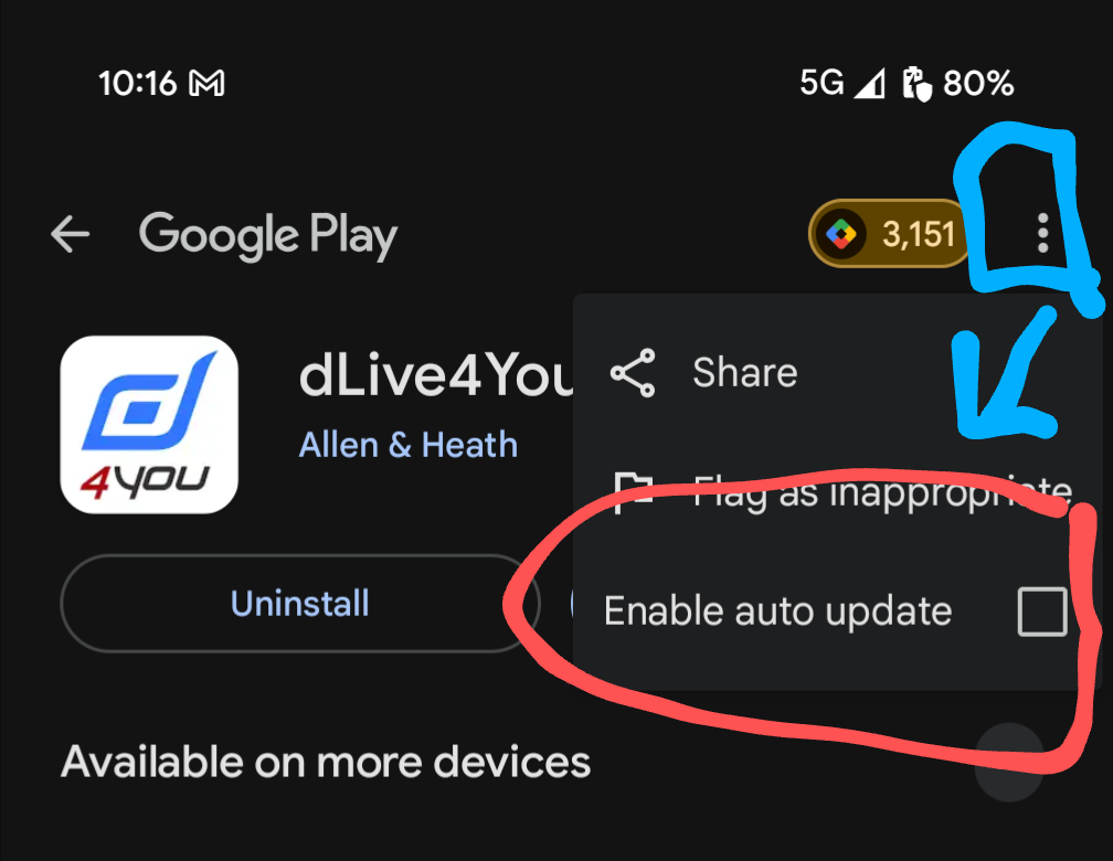

The correct solution here is to simply turn off automatic updates on these programs. Now I realize that Apple and Google app stores both default to making apps update automatically, but people can easily change this setting to “manual updates” which requires a person to press the “update” button themselves before the app will install a new version. At least for Android it can be set like this. I don’t use Apple devices to know for sure.

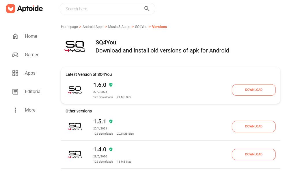

I’d like to add something about Android:
In addition to the Google Play Store, there are alternative sources for Android apps, such as Aptoide.
There, you can also find previous versions of SQ4You for installation.
Of course, installing apps from non-Google sources is always a bit riskier, but Aptoide is also considered trustworthy, and I personally haven’t had any problems with it.
However, I don’t do this on my personal phone, but only on older devices that are used solely for control purposes, for example.
These don’t even have to be particularly up-to-date—even the latest version of SQ4You only requires the 10-year-old Android 6.
Typically, everyone has one or more such previously used devices lying around.
But of course, this isn’t my recommendation, and despite the green trust mark, neither I nor anyone else can guarantee 100% security - everyone has to decide for themselves !!
