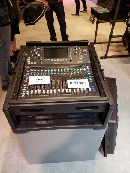

While at NAMM we stopped by the SKB booth. They have a new product the “1SKB-R102W”, this is new and probably not going to be available for a few weeks, but looks to fit the SQ5 quite nicely!
I believe these will come in 2U, 4U and 6U spaces below the mixer, W means it has Wheels / Rolling rack, but they will also have the non W version.
Pictures are attached.
Thank you so much, Johnny, for sharing your NAMM experience. This is a serious option!
