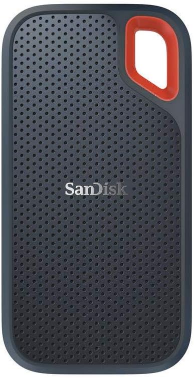

Kingston Data Travelers…
They work fine for standard recording, audio file playback, show storage and scene storage.
The big SanDisk I linked to in another post and referred to here is a big fast drive
great for large multitrack projects and can be used for all the above as well.
