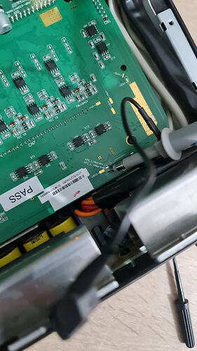

I have the same problem with the qu-16, slowly a noise appears as if the GND wire is missing at the signal input, until finally the console freezes and does not start. I replaced the CPU board (04-362 PCB ASSY QU-16 CPU) it did not solve. I noticed that the problem appears with the heating of the DSP out microchip ( pcb 004-1342). I also simulated the defect, if I heated it to over 60°C I could block it immediately. I replaced the DSP chip, it did not solve. I replaced the DSP pcb board, the problem reappeared after 2 weeks of use
Hello again, I’m back. Last night I disassembled the mixer again, checked the SMPS source, replaced U4 TL431, removed the C4 capacitor, put 3 light bulbs as loads (Be careful, do not power it without a load! the capacitors on the +/-15 V outputs will explode, it only has feedback on the 7.5V output). I adjusted the source to 7.5V, I took the PCB board with the XLR/jack connectors, I redid all the solder joints of the connectors that make the connection between the boards, I reassembled it, it started from the first time, I heated the board with DSP up to about 82 °C (that’s what it says on the display) from last night until now it’s been running continuously, that humming hasn’t reappeared, it hasn’t stuck after restarts, it seems to be behaving normally, I’ll be back with news!
That’s awesome ! :+1:
Giga
H
ello guys! I’m back with news regarding the problem with my QU-16, I found the problem and the solution. So the problem was as follows: after a while, especially when it was heating up, a buzz appeared on all the outputs and you couldn’t turn it back on until after a while. on the PCB board with DSP for outputs there is a network voltage monitoring (in the service diagram the power supply diagram appears, and it is noted PSU_PF1L, normally it should stay stable at 3V, when D1 and Q1 heat up, it seems that Q1 acts a little earlier, thinking it is a kind of “on/off” and hence that specific buzz. I replaced C1, D1, Q1, R1, but I only moved the defect to a higher temperature by over 15..20C. The solution was to insert the D1 diode in series with another diode so that the optocoupler cannot be activate Q1. I am very curious what the purpose of “PSU_PF1L” is,
maybe a qu-16 developer can explain it to usTHANK YOU! I managed to make some videos simulating the defect) if you want I can show
