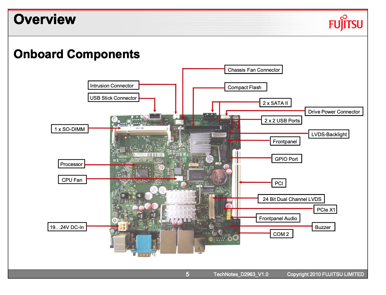

Can you let me know which SBC you have? When I repaired mine I had to use one of the pins on the SBC to start the computer part of it. It’s essentially the same as a motherboard header on a reguar desktop PC board.
If you’ve got the Fujitsu board then have a look for the Front Panel Connector, on mine I needed to short pins 8 & 6 together & that booted the SBC. After that it’s a case of going into the bios & putting att the settings back to where they should be.
Here is my computer. I think it is a Fujitsi but more updated.
I think my computer is a Fujitsi. Possibly a newer one. Here is a picture.
Dewey - that is the Fujitsu SBC. Try what fender_jazz_72 recommended.

Also what is the best way to access the computer fully? I have taken off the sides and the back of the T112, but I can’t seem to get enough access to any of the pins that you mentioned.
So I took the screws holding the SBC out and was able to wiggle the SBC out the console. I then bought a cheap power PC power switch from Amazon. I hooked this up to pins 6 and 8 as per the recommendation and the motherboard documentation. I put the SBC back in place and powered up the console. The SBC didn’t go on when the console powered up, but when I pressed this the external PC power switch, it sprang to life and I had video on the external monitor and the USB keyboard was working. I followed the BIOS reset instructions, restarted the console and the touchscreen came to life and booted up.
