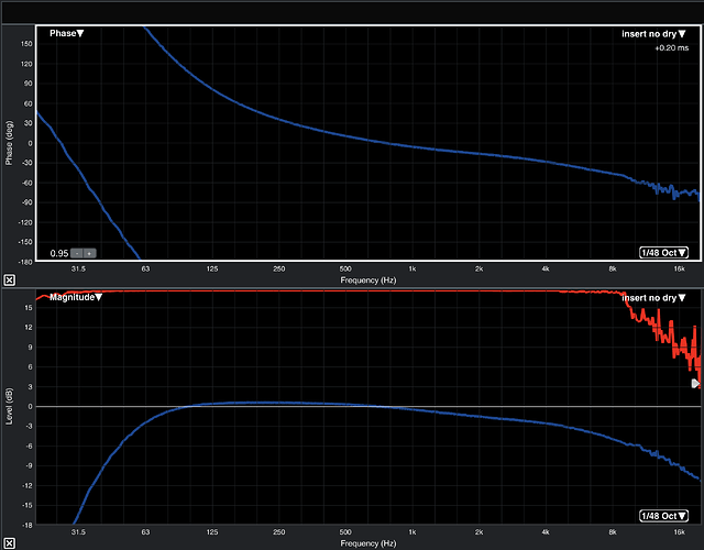

So here come a few screenshots of measurements I did yesterday.
Conclusion for me:
  1. Saturator wet+dry is a no-no if bass below 100 Hz is important
  2. wet only has, dependent on the settings, still more or less lowcut. This I have to verify, if or how much this is important on bass heavy groups and /or masters.
  3. so my initial feature request remains: please give us a sidechain option with lowcut
  4. and as a additional feature request: please give us a readout for the set punch frequency. At least I couldn’t find any.
Thanks for reading!

Just found a mistake in 3 of my screenshots. Forgot to take into account for the 0.2 ms latency added by the UFx.
Although this changes nothing of my conclusion, let me add the correct screenshots, for preciseness reason.
