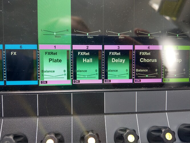

- When using copy/paste/listen buttons while channel knobs are assigned the text is out of bounds and not fully readable
- When touching a fader the left side of the channel area has a dark bar which makes the text of the knob assignment hard to read
