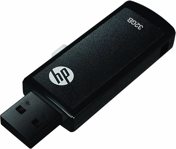

See below. We have THREE of them and they work in either USB port anytime… Plus they have plenty of capacity for recording and hen we bought them they were only $18.12 each…
We have successfully used HP 32 Gig ones with V255W on the label. Latest order info:
Amazon:
3 “HP 32 GB USB Flash Drive (P-FD32GHP255-EF)”
Personal Computers; $18.12
Posted - 27/07/2012 : 20:39:03
Here is the link to the HP 32 Gig ones:
