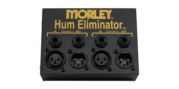

I was plugged direct into the hi-z input, and that’s when I was getting the bad hum. When I added the Samson MDA1, the hum got a little better, but it introduced a lot of hiss. So now my question is, if the Hi-Z of the ZED eliminates the need for the direct box, to address the hum, do you think the Morley Hum Eliminator would be all that I actually need?

No, a hum eliminator will not help. Those device are to solve ground loops issues. Your issue is EMF/RFI related where the guitar is acting like an antenna and pickup up EMF or RFI and rectifying it into the audio band. When you touch the strings or metal parts grounded to the guitar itself, you’re shunting that noise. There may be a wiring issue with the guitar. Also, with high impedance guitar pickups, the guitar cord itself can have an impact on the noise pickup. Have you tried other guitar cables? Lastly, when using DIs, you don’t want to use a passive DI like the JDI unless there are active devices such as pedals between the guitar and mixer or an active pickup system. For passive pick systems, you want an active DI between the guitar and the board.
