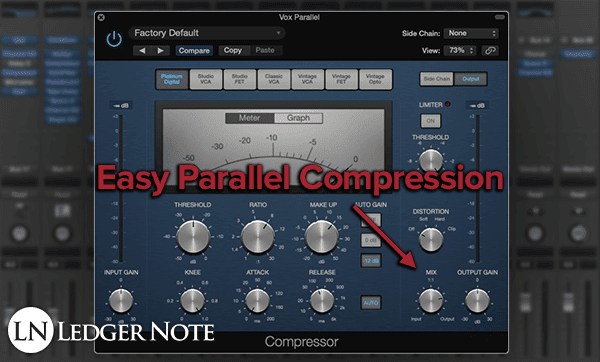

The following text and links are posted on behalf of @volounteer -
Order of EQ https://www.izotope.com/en/learn/6-parallel-compression-mistakes-in-mixing.html
look at #3 – the others are good advice too
With normal EQ, or EQ’ing after a compressor, all of the unaffected frequencies are anchored while you change the level of the frequencies affected. EQ’ing the predominant frequencies before a compressor has the effect of anchoring those frequencies you’re changing while adjusting the levels of all other frequencies.
see item #6
Most modern mixing plugins, have a Mix / Dry knob on them. This is a ratio that allows you to set up the effect you want and then say ”I only want 80% of the effected version of the track while keeping 20% of the original dry version.”

and parrallel compression is not the same as upward compression
even Wikipedia knows that (ok a lot of HipHop “producers” from the US mix this in a lot of sources together)
and I’m still waiting for the hardware upward compressors
I also note that a number of experts apparently did not know about parallel compression before this discussion.
I would say that statement is wrong!
It’s used more in the studio world that live, the SQ can do parallel out of the box.
