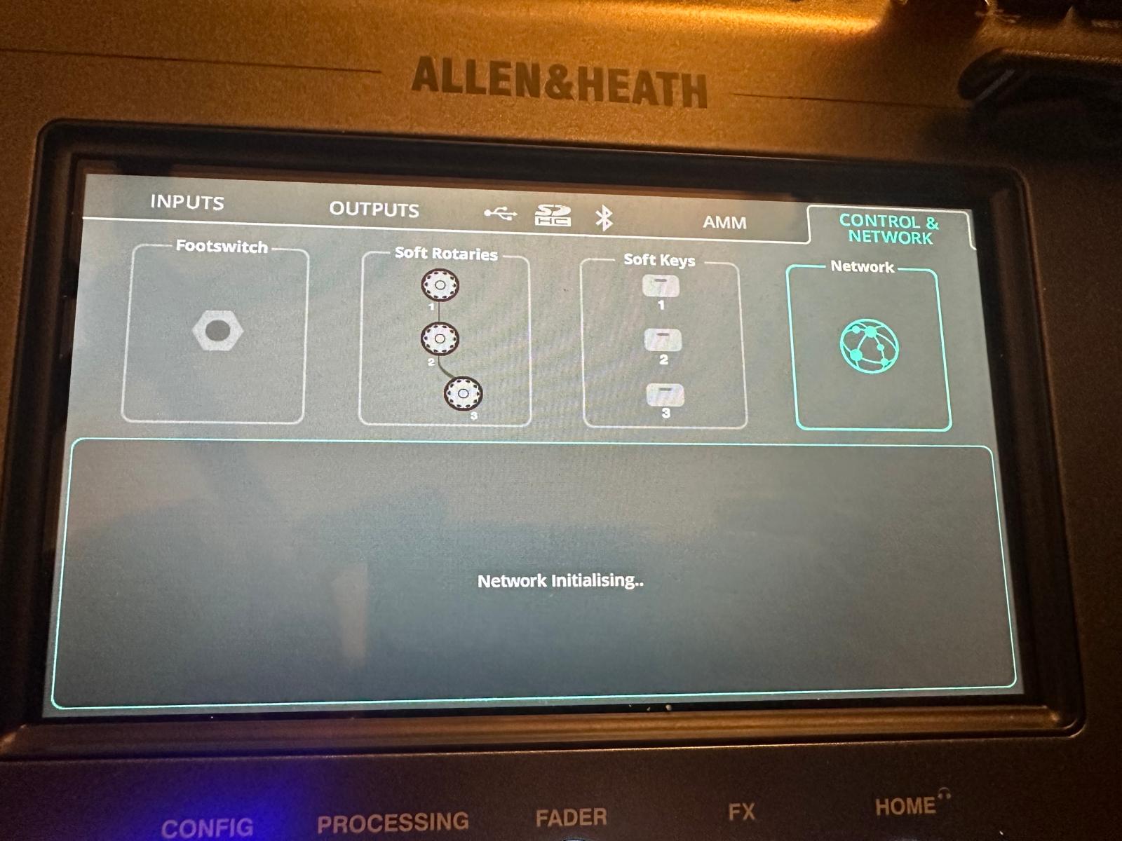

The desk had been booted up for around 30mins before I was ready to grab my iPad. Then found that the network was stuck on initialising.
Rebooted following the correct procedure. Still stuck, getting nervous now. Rebooted again, waited and waited. Enable Ethernet / WiFi access point buttons are both greyed out.

Played with different firmwares. I don’t think it’s a firmware issue. Reproduces on 1.1 as well (see a screenshot). Tried to stay on 1.2.0, as it’s reported as a bug fix for this version and bug might be reintroduced in 1.2.1. But nope, it happened for me in all 3 versions I’ve tried 1.1, 1.2.0 and 1.2.1. It seems to be rare, as most reviews are 5 stars. And I want to replace it for another try. Keith, if you want to get this exact one where the issue is easy to reproduce, please let me know and steps to be done. Otherwise I’m going to return/exchange it in guitar center in a week. It’s a great mixer, and I hope this glitch is very rare and the next one will work properly.
Screenshot
