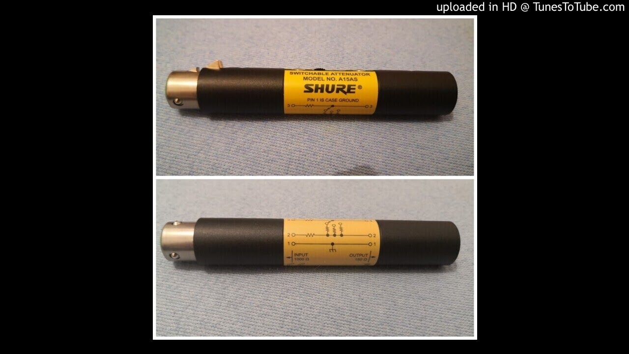

How about this one?
https://www.sweetwater.com/store/detail/A15AS--shure-a15as-switchable-attenuator
@Dado
That would give you attenuation so if it is enough then that is a solution.
Playing softer is always an option. You just dont want to do it.
The Shure pad would work.
I would not plug the pad directly into the back of the mixer, use a short cable between the pad and the mixer. Having something that long stick out of the mixer is an accident waiting to happen in getting the connector broken.

No pads on Earthworks mics but Earthworks makes inline pads. But at $100 a pad I would go with the Shure or a Whirlwind first.
Thanks a lot everyone, I ordered the Shure one.

UPDATE:
Guys, I finally got the Shure attenuator, and the problems haven’t quite gone away;
this is what’s going on: with the attenuator the signal level was indeed lower (15,20 and 25db of attenuation) however, the distortion is still there no matter which of the three I set it to.
Here is how it sounds with all three sets of attenuation:
Now, what I tried to do was to start off with a clean scene and there was no distortion with the signal. Added some eq, still ok. But when I added reverb (one of the mixer’s fx reverbs) it then started to tear.
